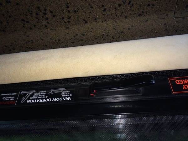

    This thing is the only thing in the bus that rattles when I am driving. It isn’t all the time, but it is enough to drive me bats. Twice I have had Liberty look at it, but whatever they do is only temporary. Any ideas on how to fix the vibration?

    Karl, the track is the rattle. As it travels back and forth in a channel it starts and stops with a ball bearing falling into a slot.
    The red lines are on the handle to mark open and close. If the handle travels to far “opening” then the ball bearing falls out from the horizontal track behind the frame…thus your rattles.
    Liberty, probably replaces the ball bearing and then someone opens the window lever, the ball bearing falls out… it starts all over again. Who could be the trouble maker here ?
    We found that using some care in opening the window handle, watching the red mark when they line up prevented any further problems.
    I’ll offer to fix it at OKC for a cool beverage !
    AL
    June 10, 2014 at 7:56 am
    I have had to adjust the mechanism to have it tighten up the rattle. When the motor pulls the window shut and tight it is OK, but after some driving it seems to relax and the mechanism is not as tight and then it rattles. I cannot remember exactly what I did without going out to the coach but it wasn’t a big deal. I has been about 2 years since I adjusted it and it has not been a problem since. Only one window has required the adjustment.

    I think I fixed the rattle today. I opened the awning, then the window, then tightened a screw holding in the handle from the outside. Crossing the minefield that is the streets of Vermont, New Hampshire and Maine it seemed quiet. Now, the blinds vibrated with every bump, but I think the handle was quiet.
