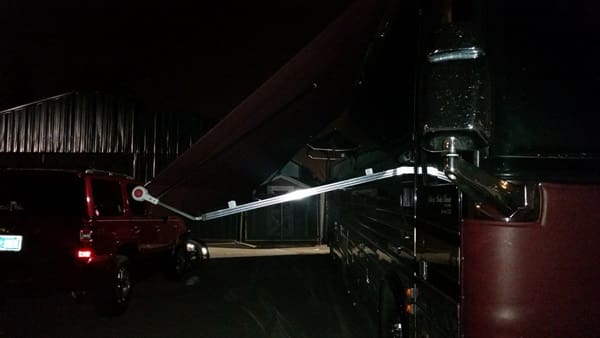

    So my good friends, what’s the secret when these awnings start acting up? When I opened mine today it wouldn’t open using the Creston so I used the switch inside the control box. It opened but it opened very slowly. Tonight I tried to bring it back in and the extention arms retracted but that was it and at first they didn’t even come in. It was delayed. I’ve tried bringin it in with the switch in the control box but nothing happens. I am aware of water getting in the arms when it rains so I have drained the arms every time it rains.

    We are working today but I’ll try that later. Here’s one for you. I came outside and the awning was back in the full open position. No buttons had been pushed. Ten minutes later, again no buttons pushed, it went back to the position shown in the picture above. Go figure.
