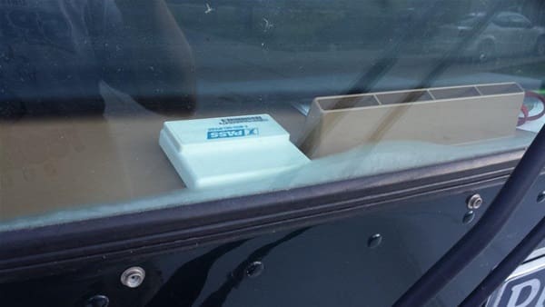

Posted by Dick on June 7, 2015 at 10:03 pmThis is the worst of two spots on the passenger side windshield. I presume that the windshield is three layers; lexan or something similar in the middle with safety glass on either side.
What is happening? Are the layers delaminating? Is this common?

I’m guessing it’s turning yellow and brown, probably in the corner, only real cure is windshield replacement, the ones on your coach are fairly easy to do.
Yeah, I know what your talking about, it’s under the outer laminate layer, replacement is the only way to eliminate it.

The layers of the windshield “sandwich” have moisture or air between them.
The probable cause was the rubber molding allowed water to enter the groove the glass sits in, or it could be the layers just separated.
