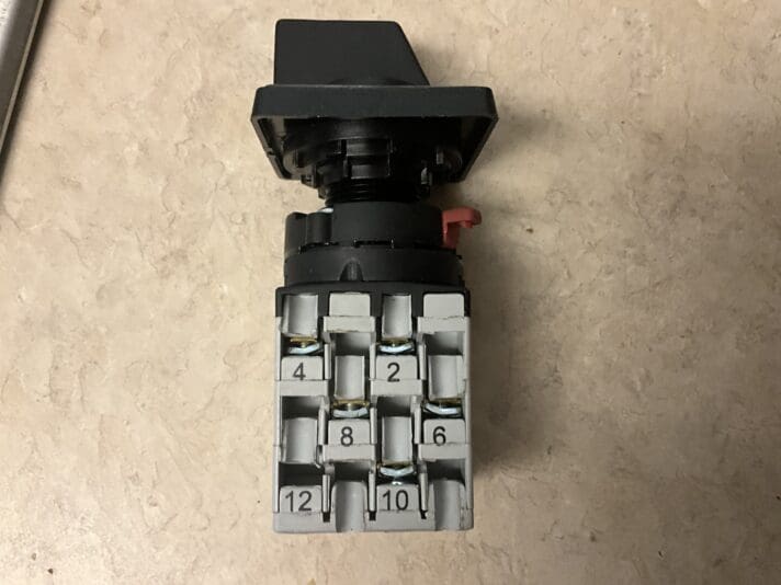

    Jon, im thinking its the selector switch, its very hard to move from one location to another. We finally got it to move and could heata solenoid working sometimes. Got enough in the front to get the coach to move. I’ve ordered a néw switch but didn’t get the instructions

      Hi Mike. I have a 1990 Prevost with level low problems. I too ordered a new selector switch. Its wiring is different from my old one. It didn’t come with any instructions either. Did you ever find out how to wire the new switch in.

    If your converter did not modify the Level Low system, when you get the new control (assuming that is the issue when you replace the existing one just do the change one wire at a time. There are a lot of wires so be sure you do a correct transfer of wires.

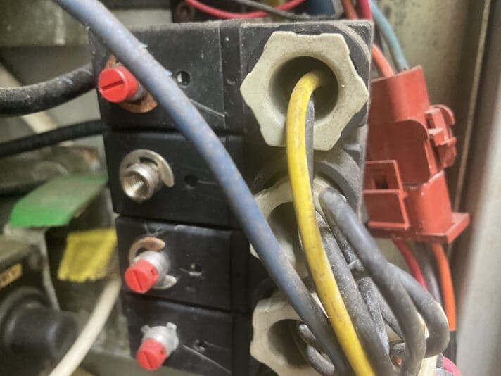

    Hi. I actually bought my 1990 Prevost 10 years ago to take my wife on a cruise around the country. Right after I bought it she got cancer and passed away. It has been sitting in my yard ever since. Recently I decided to play with it. I can’t get it to raise and lower. I replaced the 4 valves with the red tips. Made no difference. Then I replaced the up/down switch on the level/low. No difference. Then I ordered the rotary switch on the level low. I got it but it wires up completely differently. I have no idea what color wire hooks up which terminal on the new switch. My auxiliary compressor barely makes 50 lbs of pressure. HELP i know absolutely nothing about busses or the whole air suspension system. I’ve been reading posts and trying what they suggest. A good note is I actually got the bus running again after all these years. I’ve learned a lot. Thanks everyone
  • Jim
    July 4, 2025 at 2:15 pm
    Here are some photos. Thanks

      Are you able to build air in either of your systems? What do the gauges read when the engine is running?
