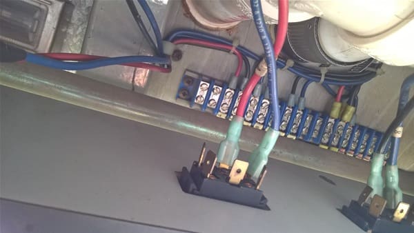

    Looking to get a toggle switch that liberty uses all over the place on their Liberty Classis (late 90’s) coaches.
    This one is used on the port dump. has 6 blade attachements on the back and is a simple black toggle switch. One of the blades is breaking, so doesn’t give a good connection. need to replace.
    Pics of the front and back below.

    charles if it is the one on the picture just move wires to other side as only half the switch is being used as in lower photo…

    thanks jeff. guess it makes sense its a two way switch. guess the pther blades allows it to contol multiple items with a single switch. will swap the wires and test tomorrow.
