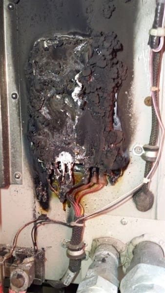

    What was this? The first member who correctly identifies what this “was” will win a FREE one year membership in the Prevost Community!!!!!!!

    My totally amateur guess: Originally I thought something overheated and burned in the electrical circuit. But then I looked harder, and it looks like corrosion caused from a circuit, almost like corrosion on a battery, which built up and got covered in grease.
    Probably way off base, but a free membership is hard to pass up!

    Vanner Monitor.

    Yea, Vanner monitor. I remember reading the reason for the recall was the sealing clear resin protecting components. visable on the back side can under certain conditions start on fire.

    Tom is the winner, it “was” the Vanner Battery Monitor. Even though founders, owners, administrators, employees, and contractors of the PC, its Forum and website probably should have also been ineligible.
    The “event” also melted two air lines above the Monitor which needed to be fixed.
    It sounds to me like these have had a problem in the past. The replacement I received from Inverter Service Center is model EM70D. I can only presume the one that destroyed itself was original to the 1998 Prevost chassis. Randy Seabolt from the Inverter Service Center express surprise that it melted down.
    Check your Vanner Battery Monitor for the model number. If you have an older monitor that might be prone to destroying itself, my recommendation would be to consider upgrading a more current version. Someone might know which of the model numbers could be a problem.

    Dick the ones with lower letters like EM70A are old and have had problems the newer ones
    like EM 70D have less problems

    Regardless of which version or model, there MUST be fuses put in the battery sense lines. Prevost generally puts these where the monitor reference lines are tapped off at the Vanner battery equalizer. Make sure this has been done or add them yourself. waterproof in-line ATC fuse holders with 3 or 5 amp fuses.
    We have seen many that looked just like the post pic above. The really stink when you let the smoke out of them lol.
    April 27, 2015 at 11:17 am
    Jeff Rowe and Randy Seabolt from Interverter Service also said to fuse the lines. I was expecting to fuse the “battery sense” wires as you suggest, but when I received the new Vanner Battery Monitor (Sending Unit) and looked at the instructions, attached below, it looks like Vanner is suggesting to fuse the three outgoing wires to the indicator lights on the dash.

    Now I’m confused about how this should be fused. Fuses on the incoming wires? Fuses on the outgoing wires? Fuses on all the wires?
    April 27, 2015 at 12:57 pm
    The input wires should be fused at their source, not at the monitor. That way everything downstream from the source is protected.
    The wires that send the signals to the tell-tale lights shoudl be fused at the monitor.
    April 27, 2015 at 1:02 pm
    Six or seven fuses then.
