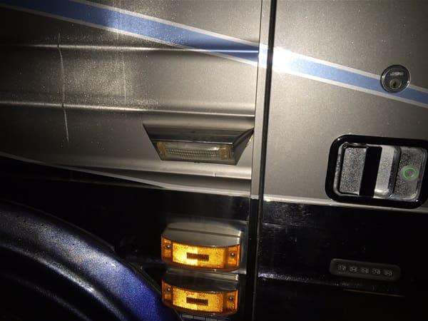

    Posted by Walter on January 20, 2016 at 12:52 am
    the one in the middle of the top row… mine isn’t doing anything.

    On my ’01, the “Entry Light” is the exterior light as you come in the coach to the left of the entry door.

    January 20, 2016 at 9:28 am
    Correct, it’s the light at the outside entry door.
    This past trip we ran into an issue where the light would not go off. I’m thinking it’s a sensor that thinks the door is open when it is not. Any other Marathon owners have any ideas? I did confirm this is Marathon side not Prevost side.
    January 20, 2016 at 2:59 pm
    I see – that light doesn’t go on on mine. Perhaps it’s burnt out. I’ll have to open it up and see what’s going on.

    January 21, 2016 at 3:51 pm
    I took mine off and it’s more like a halogen fog light bulb inside of a rusted up focusing cone. And yup… it’s burnt out.
    I went to superbrightleds.com and entered DES-3175 and got no results – I tried DE-3175 and got the festoon style bulbs that are in the bays. Is DES-3175 a typo?
    I did want to get LED’s for the bays…. so all wasn’t lost!

    ORIGINAL PHOTO
    And it’s the top light in this photo

    January 21, 2016 at 8:22 pm
    Walt,
    We’re in a word maze.
    Round light upper left top of door standing outside….entry light,door opens light on
    Light left of door key ….padio light.. BUT, Marathon would use this light 2 ways.
    Opening door on..off…
    2ad way… stays on if switched inside.
    I’ll find LED number for padio light and get back to you.
