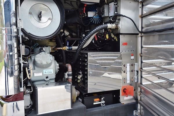

    I seemed to be having an issue with the circulation pump downstream of the webasto in the rear STB compartment remaining on long after the webasto heat cycle is complete, actually doesn’t shut off at all. As I understand the cycle, the circulation pump should cut off approximately 3 mins after the webasto shuts off, unless very cold ambient temperatures exist. I was wondering if the signal to turn on/off the circulation pump is coming from the Webasto or if a separate control exists and if anyone has dealt with a similar issue. Seems to me that the shut down signal is not being processed. If I shut off the webasto on the crestron, he circulation pump shuts off a few minutes later, thanks in advance!!

    I believe the cool down timer is a function of the brain box, controller.
  • gary
    September 13, 2014 at 11:35 pm
    As long as the webasto is on the pump will be on all the time but not the burner , just the circ pump on only unless u shut it it off completely
    September 14, 2014 at 9:44 am
    Good reply Peter, I thought he was telling us the pump wouldn’t quit after shutting off the Webasto.
    September 14, 2014 at 11:33 am
    Thank you, I misunderstood that the circulation pump would quit once temperature levels were met by the Wabasto. It’s important to understand how functions are suppose to operate to evaluate if all is correct. Based on this all appears to be working as designed. Thanks again!
