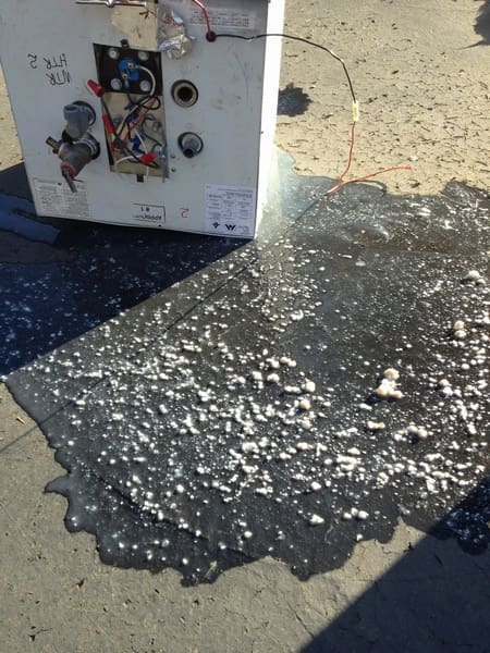

    Posted by Greg on March 24, 2012 at 12:59 am
    If you haven’t clean out your water heater it could be time, especially if it’s older.
