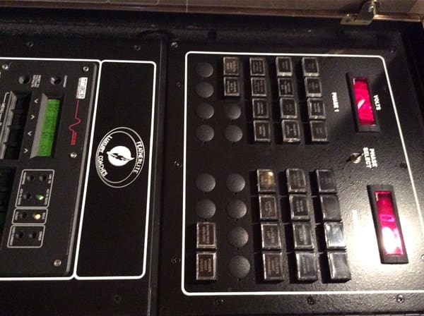

    Good morning guys,
    Would anyone happen to know offhand where the breaker/ relay might be for the mid coach switch assembly? This would be the switch bank that is with the phase 1 and phase 2 led displays that controls power to fridge a/v water pump etc..
    There is no power to either key pad but the led’s are working. I’m thinking that there is a breaker somewhere that has tripped. We have recently had chassis batteries replaced and thought that maybe a breaker was tripped or it could just be coincidence.
    Thank you,
    Chris
    2004 Vantare

    February 11, 2014 at 4:04 am
    there is a black control box on ceiling in first bay driver side. There is a power supply in that box. Donnie Myers walked us through the bypassing of breakers to get us by until we can get to him. He definitley knows his vantares! It took him about 30 seconds to diagnos the problem once I told him the symptoms.
