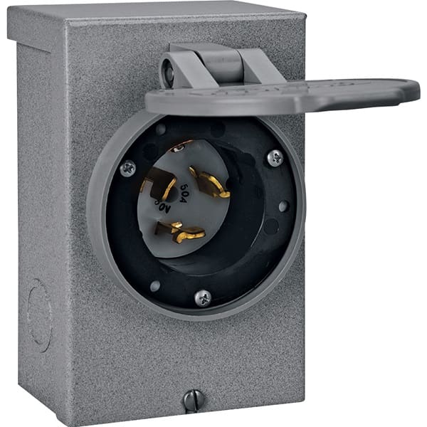

    The new service for our house enters the race shop (and then branches over to the house) right next to where the coach parks. The electrician has a transfer switch all installed. All he needs to do to finish is put in a reeptable to plug the cord from the bus into it. I plan on using the 50amp “buddy plug” that Liberty has in the electrical bay.
    I’m sure I’m not the first guy who has done this. What kind of plug did the rest of you guy use to plug into the “stationary house”? The electrician found this box and receptacle. I notice that it looks like the shore power plug in the curb side of the bus, so I could use the same cord for curb side shore power as well as powering the stationary house off the coach generator, and if I can find an adaptor I could use that cord as an extension to the shore power cord on the reel in the street side of the coach.
    I’m now realizing that the plugs on the coach are only 50amps. 50amps x 120 volts gives me 6,000 watts. 50 amps x 240 volts is 12,000 watts. The Kohler is 20,000 (which I assume is peak, so 80% for cointiuous gives me 16,000 watts). By hooking the bus generator to the stationary house like this, am I leaving generator capacity on the table that I could give to the house using another method of hooking this up?
    Or is this the way the rest of you have hook your bus generator to your stationary homes?

    Yes you’re leaving some generator capacity on the table. Getting all the generator capacity to the house would require a larger gauge power cord, recepticals, and probably rewiring some of the bus. Doable, but expensive and certainly into the point of diminishing returns.
    December 9, 2015 at 12:35 am
    That receptacle looks like it is a 110 Volt, so you would only be able to power one bus in your house. Your house, if it is like the majority of houoses, has two busses of 110 V each, and 220 V between each bus. If you have a 50 Amp 4-prong plug like you normally plug into shore poower from your coach, you can power both house busses.
    December 9, 2015 at 8:12 am
    The unit shown is a 240 volt unit. The ground is thru the outside connector of the plug. It is okay, but why not use the female of the coach plug? That way you would have an extension cord when not powering the house.
    Mikee
    December 9, 2015 at 8:50 am
    Mikee is dead on, it’s a 240 volt and by using a female receptacle, you could then use just an extension.

    Mikee makes a good point, that was my original plan. Then I did some searching on the coach and discovered the shore power receptacle on the curb side is this same as this. So by using this type of receptacle on the stationary house, I can use the same cord to power the stationary house as well as access shore power from the curb side of the coach. I will look for an adapter so I can hook the new cord to the shore power reel cord as Tom pointed out.
