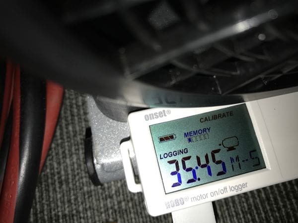

    Recently, I posted at tiring length about my aux air compressor issue. Meantime, I have had the new compressor installed and running for well over a week. However, I really wanted to know, how frequently and for how long the compressor would come on. Unless, you hang around all day and wait for the compressor to start and stop, you will be at a loss because of the time when you are not there, not listening, whatever.
    I figured that there must be a means by which all this can be measured. But I did not know what to look for. After some googling, I learned that I wanted an AC DATA LOGGER and I found the HOBO MOTOR ON/MOTOR OFF logger. By Onset Company in MA. ( http://www.onsetcomp.com )
    It required a download of their software as well as the calibration of the logger unit. This took only a few minutes and was easy. The logger is very small. About 3 x 2 x 1/2 inches.
    Now then, I have had the logger installed for 3 days. It attaches with a magnetic base (or Velcro or a strap) to the compressor motor case, frame or anything metal and it senses when the motor coil is being energized (switched on) and when the motor stops runnning. The logger keeps a tab of the date and the from to time runtime. I downloaded the data into an Excel spreadsheet.
    Thus, I did learn that the aux compressor turns on about every 2:32 to 3:05 hours and that it runs from about 3:11 to 3:22 minutes each time.
    The Hobo Motor On/Motor Off Logger cost me $97.00 on Amazon.
    Expensive learning lesson but I just had to know.
