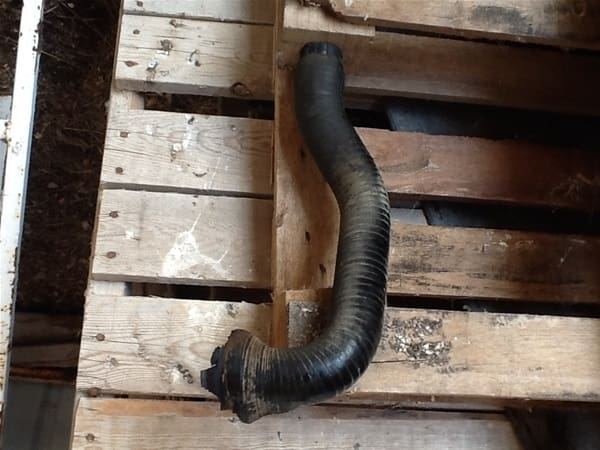

    Got to Winnipeg MB at about noon had the afternoon off so I needed to service gen ,changed oil and filters was looking things over and found turbo hose soft under the air cleaner had new one and put it on , heads up guys make sure u check the turbo hose it is a different size on one end , the old hose was cracked at the big end and may have had a small hole in it , when I took it off the big end was very hard and cracked under clamp glad I found it, also glad I had spare one , it came apart when I took off clamp
    I usually put about 200 hours a month on the gen I need it so good to keep up with things ,like a spare hose

    Peter,
    Where did you find the replacement hose? I can’t find one locally.
    August 19, 2015 at 10:32 pm
    You can get one from Jeff Rowe I always carry a spare had the spare about one year then used it today, good thing I had one can be hard to find
    August 19, 2015 at 11:21 pm
    I have had to buy the Kohler equivalent from Clark Power in Atlanta.
