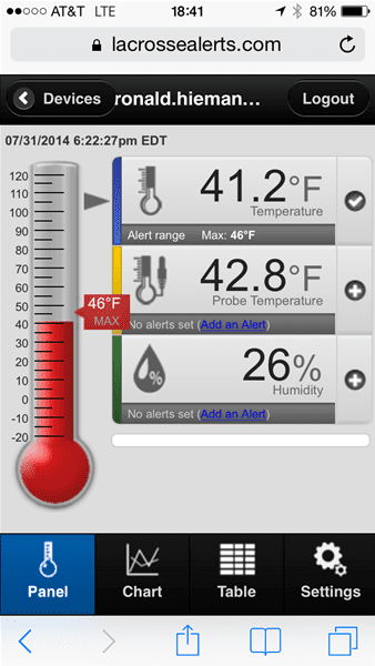

    In the absence of alerts, you can always, at no cost, visit the web page. This is also a secondary safety feature because it will allow you to get piece of mind when you login to your account. The information is being updated every 15-20 minutes and it shows on the web page when the last update was transmitted. That will tell you if the system is working. The following photo taken during the test phase shows you what it looks like on an iPhone.
    Not to confuse you, there can be 2 temperature readings. The first one is by the thermostat sensor itself and the second one is from an attached probe (detachable) on a 6 feet long cable.
    This comment makes me wonder whether I really need the 2nd sensor I bought. Perhaps, I can keep the thermostat outside and leave the probe inside. That would provide me with bus temps and freezer temps. Food for thought.

    I did what I was wondering about in my original post. That is to say, I moved the thermostat outside. Now I am getting the inside bus temperature reading and the inside freezer reading. Makes sense because why would I need 2 readings from inside the freezer. Good thing about Amazon is that they offer hassle free returns. They even provide you with the return shipping label.
