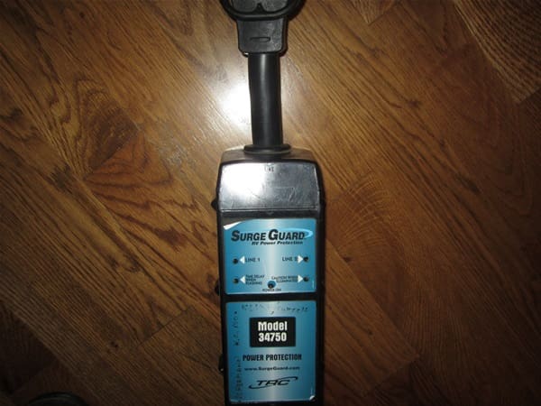

    Couple of weeks ago when I arrived at the bus barn I could hear an alarm going off inside the bus. Battery Low light was on with audible beep.
    At the inverter panel, error code on #1 inverter. Checking things everything is normal all the switches are in their regular position. I reason their must have been a power outage and switches didn’t reset.
    Unplugged everything and started over. Everything came back. I wrote it off.
    Getting back from Dallas everything was done as needed with bus make ready for parking. When I returned to the bus for the last items to go home I find the inverter lights, one green power is good and amber for bulk charge are not lit. I have no electric service. Bus is operating on inverters.
    No trouble the entire time in Dallas. Below is what I removed from the house plug inside the bus barn and everything was normal.
    My electric service protector has failed. Removing this from service everything was normal. This protector is about 4 1/2 years old and saved me once at an RV campground prior to plugging in the bus. Other then that has worked great.
    Any one had this experience ?

    yes. I’ve had the TRC version fail. It only has a one year warrenty and was replaced since it failed within that time. I understand the Progressive model has a lifetime warrenty, if I had known that I would have bought it.
    On mine the LCD fails tyo illuminate and restore the power after an outage. Happened twice and I sent it back.
