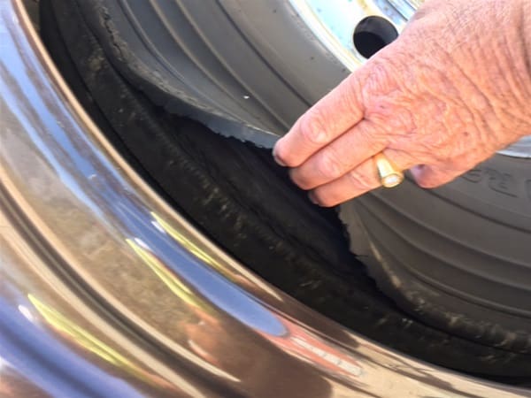

Sid’s tag axle tire failure
Posted by AL on September 15, 2016 at 5:11 pmSid asked me to post picture of a little problem with a tag axle 365 Michelin tire.

Looks like the same failure that we caught a bit earlier leaving PC rally in OKC. There was a thread at that time. We think rotation from steer might be the problem. Geo.
I’ll try to answer the best I can
#1 I run 100 on the tag
105 on the drive
110 on the steer#2 Chris yes I did rotate the steers to the tag every time when I put on new tires
The date on the failed tag tire 26/13
The date on my new 365 are 42/15#3 Prevost Mira Loma is going to get ahold of Michelin and send the tire back.
I’m just thankful that they had 2 that I could buy. Talk to some other tire companies in the area
And there is a 6 month back order. Maybe a guy needs to invest in 365 tires and forget the cattle business
For what they charge for them. I’m just glad to be back on the road and thank God that I didn’t have a
Blowout on the Interstate 10. -

There’s a thread on chassis section re rotation of tires. I, too, have had 2 different tag mounted tires fail after being rotated from steer. Don’t have a scientific explanation, but I no longer rotate.

Tom, I just stop in a rest area on our way to Newport Beach and did a walk around and that’s when I noticed it. I was on the 10 by the CABAZON outlet center.
