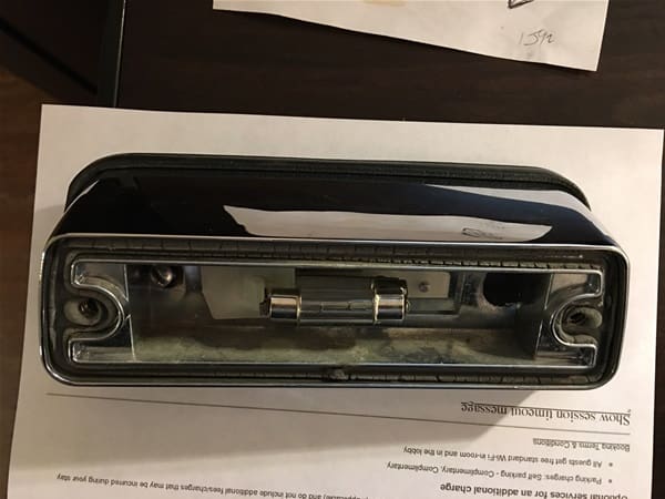

    I’ve been a Prevost owner and PC member just for over a year. I have used the Community as a resource many times and need some assistance. I am searching for a source for the side light bezel pictured. I have searched quite a bit online with no success. Hoping someone could help before contacting Prevost or Liberty. Thanks.

    Jon is correct, I did them all on my 01 Liberty and LMC has them.

    LMC Truck also has the lenses. I replaced all my lenses plus had a couple of bad screws, which they have in SS as well. All off a chevy pick-em-up cargo light.
    December 3, 2016 at 10:48 pm
    LMC does have these cargo lights, but they will come with a 1157 type set up with no socket. The lens will fit but not a plug and play with the festoon bulb. To use your current base lamp while upgrading to LED, look for the 44 mm festoon bulb from Superbriteleds.com.

    Thanks to Jon for the source and everyone else for the info. There does appear to be a version for a later model truck that shows the festoon bulb in the diagram. I can’t tell about the plug however.
    Does anyone have an idea what the difference in lamps may be for a regular cab and extended cab?

    I only changed out all the lens and gaskets and replaced the festoon bulbs with LED.
    December 4, 2016 at 2:31 pm
    The light for the 88-93 truck has the festoon bulb base in it.
    Call them and see what the difference is in the std cab versus the extended cab light. They are great about answering questions.
    I have bought some before and they work great. The gaskets don’t work as good as the original gaskets that are on the coach now because they are a hard rubber and when mounting them on the flat surface of the bus the gaskets don’t seal real well.

    He’s what 20 yrs will do to our 73-87 GM truck cargo lamp lens that we call a docking light.
    Classicparts.com gets $10ea, and usa1industries.com gets $9ea.

    I bought 10 from LMC for $7.95 each. Quick delivery.
    http://www.lmctruck.com/icatalog/cc/full.aspx?Page=196 Upper Left corne.
