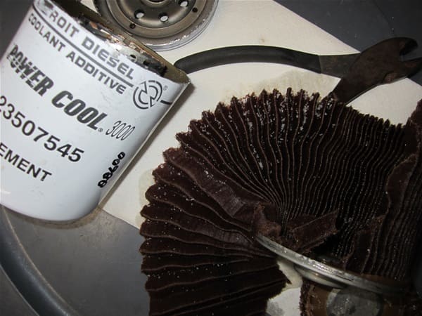

  • Should I change my engine coolant filter
    Posted by AL on February 11, 2017 at 9:18 am
    Here is the inside of a coolant filter removed from appox 4000 miles of service. Dirt and casting particles are seen caught inbetween the filter material.

    Yes, I think it would be very difficult to re-assemble that one. Seriously, that’s a surprising amount of crap.

    That is far more than I would expect to see. I would consider flushing the system before changing coolant based on that.

    I would say the coolant has not been changed on the proper intervals , before you got the coach AL , it needs to be flushed
    I change mine every oil change , and break them apart every time and have never seen that on my stuff ever
