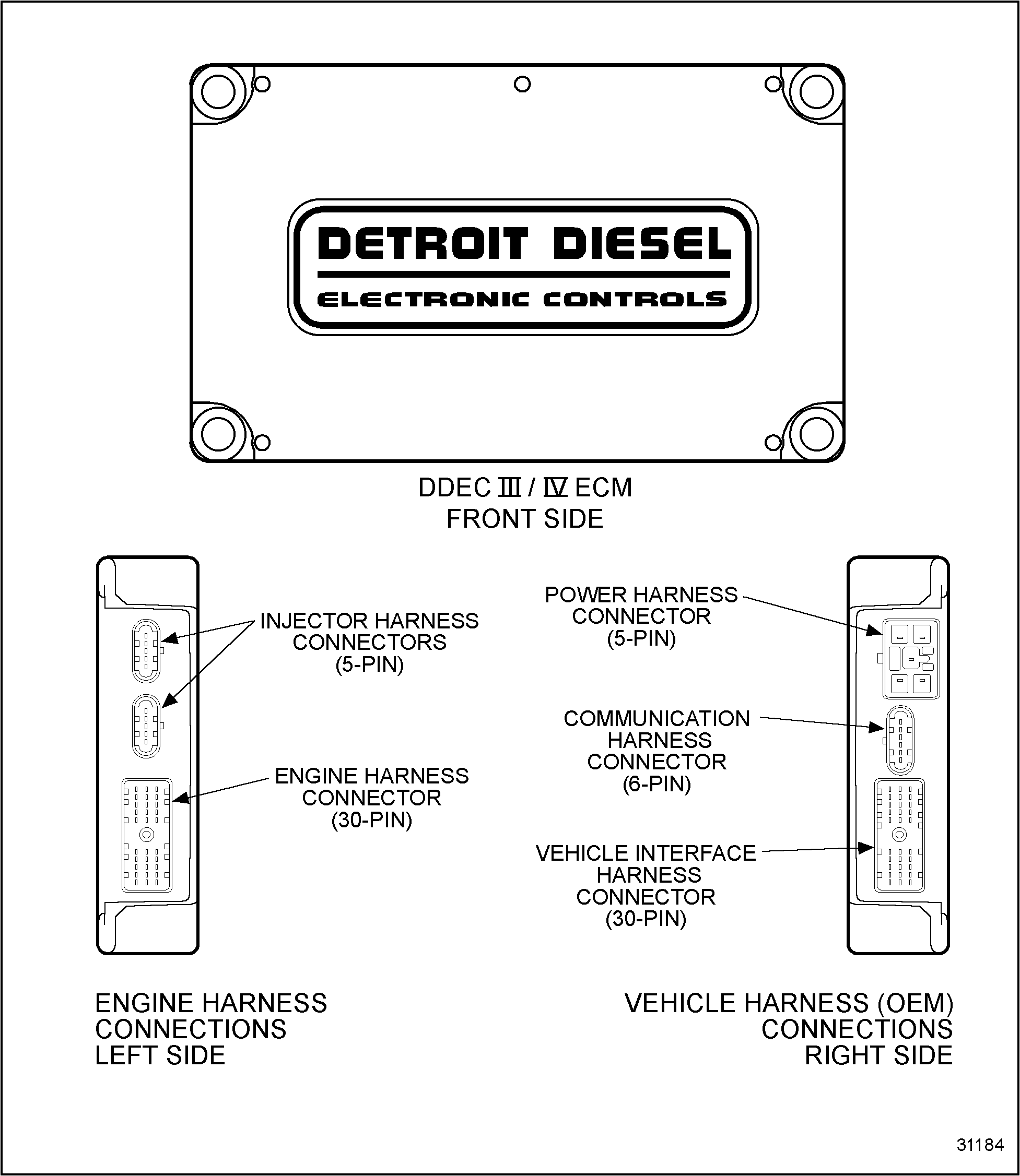

    I just put my ECM back in, and ive got 3 plugs on the front , and 3 ports on the back, but only 2 plugs. It seems strange to me that the middle plug, communications plug, would have no harness or cap. I cant recall when I removed it if there was a harness plugged into it, but I cant find it ANYWHERE. I just cant believe it would have been left empty without a cap. Can you take a peek at your bus and see if you have 3 plugs in the rear of the bus, and 2 in the front of the computer. Its the one that says “communications harness connector”, its on the front side in the middle.

    No communication harness on my coach.

    I’ll look at mine tomorrow, but it is DDEC V and might be different with respect to use of a communications port.

    Well it fires up and gauges work… so guess there was no plug. Ill verify cruise and jake tomorrow when I take it out of the garage for the 600hp test drive!

    I replaced the ECM on my DDEC III last year. It came with a rubber cap plug for one of the spaces, I do not remember which one. I was warned not to drive without it, because water would be ruinous.

    Pics of my DDEC III, 1995 DD 60s

    Don, thank you so much! This confirms I didnt mess up the install.
