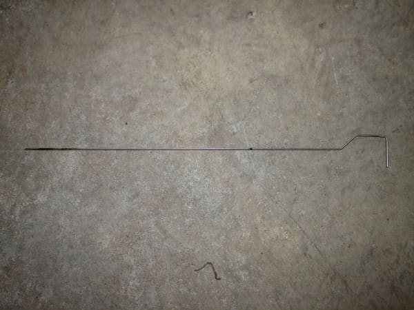

    If you have to tackle your ride height valves for adjustment or even replacement, one easy way to access them is by removing the curb lights. I also made a measurement rod with a hash mark set at 11.5″ instead of trying to hold a tape measure between the upper and lower bag mounts. For an easy method of adjustment, just mark the shock with a marker that shows the correct ride height. Now that my ride height is correct, I made note of the body height just in front of the drive wheels for a quick check anytime I suspect there is a change.
