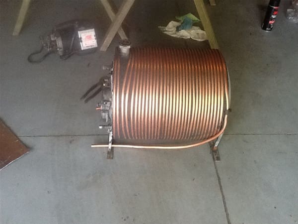

    Hi folks, I just recoiled my AquaHot and néed to know how to get the 15 gals of coolant back in. Do I have to run the AquaHot to get the circulating pumps to function? Btw the unit is back in the coach!

    Thanks Larry, sorry to say I drained the whole 15 gals and the tank is full after the first 5 gal. I’ll try firing up the aquahot to circulate the fluid thats in there and hopefully I’ll be able to get the rest in.
    I had a place here in Clarksville,In ( Stinnett’s Rv) do the recoil , they found a heat transfer mastic that they used. I hope it works it’s a lot less expensive than a new or rebuilt unit.

    Just to let any one interested, replacing the copper coils on you older aquanhot can be done. For under $1k with new copper and thermo mastic, I NOW have hot water. My wife is ecstatic!!!!!!!!
