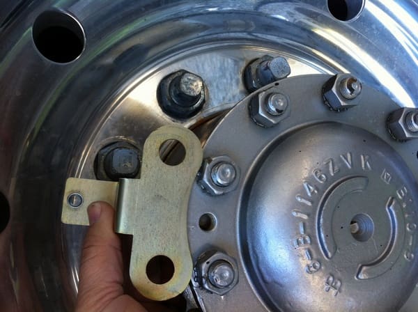

    I recently purchased a complete set of front, tag and rear axle covers from Real Wheels in stainless steel. The fronts and tags mounted with the companies wedge locks that lock on the outer threads of the wheel studs (I had plenty of thread and they seem to be very secure). The rear drive axle covers use a bracket shown below that are designed to go under a total of four (two on each side) of the axle flange nuts. I know that Prevost does not recommend any brackets that go under the stud piloted wheel lug nuts. My question is does anybody have any feedback on placing this type of bracket under the axle flange nuts? Is this acceptable or frowned upon by Prevost? Does anybody have the recommended torque values for these nuts? We have a 1999 built XL-45 chassis.

    Prevost has always had the position that nothing is to go between the lug nuts and the wheels. I have seen the type you show and the problem according to Prevost is you have no way to properly torque the lug nuts.
    There are alternative methods that capture the outside of the lug nut after the lug nuts have been torqued as you mention, or some types use covers and mounting methods that use the nuts or bolts in the hub cap itself (not the decorative cap, but the six or ten bolt cap).
    If you install the bracket and torque the lug nuts you will see the bracket deforms around the hole. It never fully conforms to the chamfer in the wheel so you have no way of knowing exactly how much actual force is imposed on the wheel to hold it secure. When these type of brackets first started showing up on coaches, Prevost, during a Prevost Prouds rally seminar in the early nineties was absolutely clear in stating don’t do it. I doubt if anything has changed their position on the topic.
    February 13, 2013 at 6:54 am
    Jon, these brackets do not go under the wheel lug nuts. They mount under the axle flange nuts just next to the bracket in the picture. This is what I am looking for an opinion on.

    Chris, my bad, I know of no objections to using the axle flange nuts. My mistake was in assuming you meant putting them uder the lug nuts which Prevost opposed.

    Thanks Jon. The picture was deceiving as the spacing on the bracket appears closer to the wheel lugs than the axle nuts.
