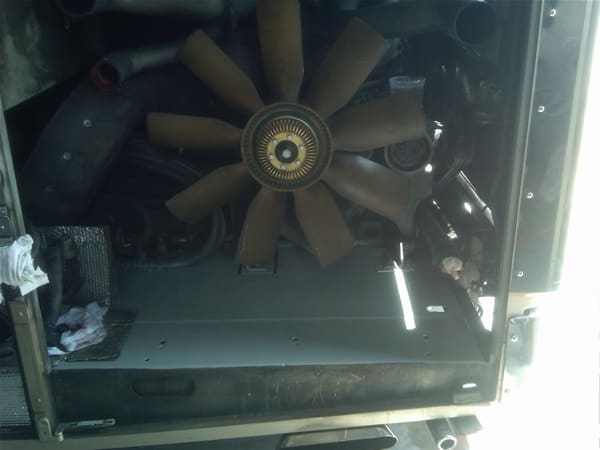

    Recently, we discovered a very slight leak in the radiator… perhaps a coffee cup full of anti- freeze leaking out over a seven day period….yet a leak is a leak …so to the mechanic shop at Freightliner in Houston we went…
    The radiator has been pulled and the “core” is being built by Hart Radiators according to Prevost specifications. Prevost parts stated it would be 60 days delivery for them to fulfill the requested part.The air cooler for the turbo is also being cleaned and serviced. We also took the opportunity to refinish the brackets and base.
    The point of this post is to observe the picture:
    Note the six chrome bolts holding on the “hub” of the radiator assembly. These were provided by Prevost when the entire assembly was ordered and replaced about six moths ago. Upon examination, these six bolts, which were tightened correctly upon installation, all had become loose.The hub became “moveable” by about an eigth of an inch. It would wobble. Even though provided by Prevost to fit the assembly, these bolts are microscopically too long and had, upon installation, actually “grounded” before they were completely “snug”. To the feel, they were tight but in reality, they were grounded.
    We took out each bolt and added another washer to support the lock washer and used Loc-tite to re-attach the hub. The bolts now cannot ground out before correct installation.
    Point:
    Freightliner stated that they see these hubs coming off of engines and have seen them go through the entire front of a radiator including the chrome front of the cab of a tractor.
    So, if ever confronted with an issue of having to replace the radiator or for safety’s sake, one might check to be certain that their hub is indeed secure. It can take out the entire radiator side asembly.
    Just thought this would make a good post. If it helps avoid a problem in the future for anyone, it was worth the effort.

    The Pres points out something very important to us all. We often put a bolt in a blind hole and think nothing of it. All blind holes should be measured to insure that the fastener isn’t bottoming out. These situations should also be a good application for safety wire

    November 2, 2016 at 9:27 pm
    The side
    November 2, 2016 at 10:23 pm
    I’ll be damned, I took mine out the back.
