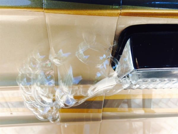

    IIf
    you’re fortunate enough to have Prevost OTR, another benefit is to be
    able to pressurize the bus to track down a water leak. Many with
    Prevost OTR already know this, but this is my first OTR and actually
    doing it to find a leak was a breeze. There is a baffle (sort like a
    chimney flue) with it’s normal position being closed to recirculate
    air.
    There is a restrict-or plate on the bay door to prevent outside air
    from being used because of dust and dirt that will be blown into the
    bus while driving. You have to remove the air intake hose and then
    open the baffle. Turning on the OTR blowers at fast idle creates
    so much internal pressure it takes two hands to force the entry door
    closed, amazing.
    I
    easily found my leak, the gasket on the light.. Oh by the way Gil,
    your CC OTR won’t be doing this.:)

    Tom is showing a leak in the side panel, but there is no end to things you can check using this method.
    If you have a pesky leak on the roof you will find it this way. If your door is making wind noise as you go down the road squirting soapy water at the door seal area while someone inside the coach engages the air door lock will identify the area that is creating the wind noise.
    You can use this to verify a newly replaced windshield will not leak.
    Unfortunately it won’t help you find leaks in the bays due to a bad door gasket.
