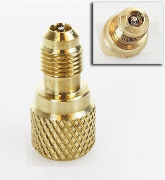

    What is the industry designation for the charge fittings on the compressor/lines on my 2000 Prevost chassis with “full” OTR Air? I have all the AC charging gauges, hoses, vacuum pump, etc. but the connections on the hoses are the residential R-22 and old automotive R-12 1/4″ or whatever size its called taper seat type. I also have adapters for the quick connect on the new R-134 automotive AC’s. However the big fittings on my coach are like nothing I have encountered so far.
    Are they ACME fittings? If so what size? What adapters do I order? I ordered some “ACME AC R134 Brass Adapter Freon Fitting 1/4″ Male to 1/2″ Female w/ valve core”
    on Amazon, but upon receipt they obviously are not what I need. The female end is even smaller ID than the male end which looks right for my charge hoses. Either these are the wrong thing, or they sent me the wrong thing vs wat the listing describes.
    What do I need to get?
