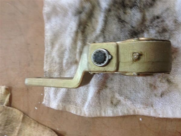

    Just on the chance that my old 8V92 goes up on the jacks at the March Maintenance Seminar, I wanted the underside looking good for Yoda and his generals.
    Before:
    After:
    How did I do?
    Not really but I did get time today to finally change out the Tag and Steer axle slack adjusters. Drive axel left to go. Interesting in that I prelubed the new slack adjusters. Some took one or 2 hits before grease appeared at the spline. Others took a lot of grease. All new drop shipped from Bendix.
