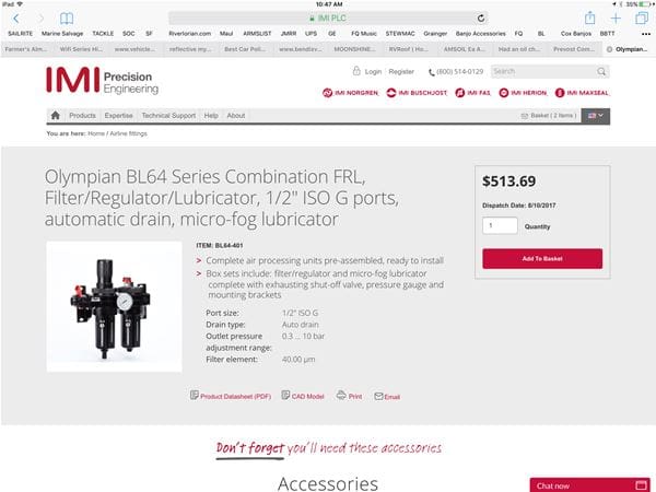

    While looking at the Norgren site and valves and all the links associated with them. I run across this Auto Drain water separating unit with an auto fog deal on it that disperses the correct fogging oil to the Norgren valves. Is this some new technology ? Are they placed on the new coach’s ? Auxiliary air maybe ? Under the directions for the valves it says USE A FILTER AND LUBRICATOR.
    So, are they new technology that has not caught on yet ? Or are they not applicable to our prevost pneumatic systems ?

    I would urge NOT to use anything that introduces oil into any of our coach systems. Norgren spool valves such as we use come from the factory with lubricant on the O rings. If any additional lubrication was required Prevost or the converrters would have been addressing the need.
