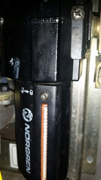

    Do anyone have a part number for a Norgren water air seperator? One of the seperators failed (leaking)
    Tom and Jon any reason the picture I posted did not show?

    Send me the pic Hish, maybe a file issue.
    September 15, 2016 at 2:58 pm
    Tom
    Thanks for putting the picture on.

    That’s the big one on the right when you open up steering bay Prevost side I replace all mine with that size easy to get

    There is nothing on those to break, but they do need new O rings from time to time.

    My separator is leaking at the valve at the bottom. So an oring would fix it?

    It might be leaking at the threads (I had one that leaked there) or you could replace the valve with one using those size threads from any store that sells a decent quality ball valve. I can’t remember if they were 1/8 or 1/4 thred.
    The O ring around the top usually leaks after a while.

    Mine was leaking also, I took it apart and cleaned it put in a new o-ring and wa la…. good as new…

    Do you have the drawings or overhaul manual this air dryer? Any pics how this unit comes apart would help.

    Let the air out of the system ,then turn the bottom bowl and it will come off, in the very top pic you can see the unlock and lock symbols you just turn the hole bottom part then wiggle it pulling down and it will come right off
    November 8, 2016 at 10:04 am
    Yep, That is how mine worked. A couple of little screws hold it in place. It is a very elementary device and an easy rebuild…

    the part needed is the valve and the top o’ring I got the top o’ring but the leak is at the drain to the bowl. No one sells the bowl assembly Liberty wants to sell complete assembly.
