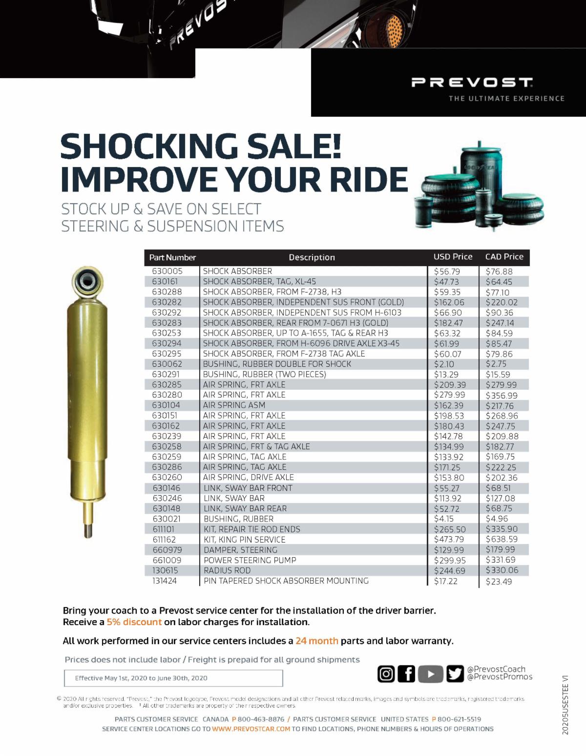

    Just went to the link at the bottom of the advertisement, same page as on the prevostcar.com promotions page. Did not see the steering & suspension promotions. What am I doing wrong?

    Top left corner of page.

    May 1, 2020 at 8:48 am
    Thanks Tom:
    Wasn’t there last night, it’s there now. Don’t know if it’s my slow internet or my slow old mind. LOL

    What part# for rear 6 shocks for my 97 XL 40 ?
    May 1, 2020 at 10:24 am
    Great prices folks.
    Art, for the rear of my bus, the old 6 rear black Sachs brand shocks #630127, Prevost now sells #630161. It’s a yellow Monroe Gas Magnum #65407. That’s what’s been on the rear of my bus for 6 yrs now. Red Koni on the front.
    Air Bags
    Steer x 2 – Prevost# 630259, GY# 1R11-244(MaeWest)
    Drive x 4 – Prevost# 630104, GY# 1R11-088(DoubleFlare)
    Tag x 2 – Prevost# 630259, GY# 1R11-244(MaeWest)

    Ordered 6 new rear shocks for rear this morning from Prevost part # 63061 for $47.73 x 6 =$286.38 not bad they are close so should get them in a couple of days, replaced front last year with Koni adjustables, I think I can replace them without pulling tires?
