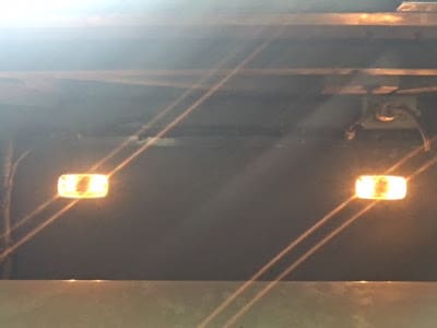

    I have been spending entirely too much time in my engine compartment lately and it reminded me to ask about something I have wondered about for a while.
    These lights overhead in the engine compartment are nearly completely useless.
    It is an overcast day here and the light from these small fixtures does not make it down to the engine at all, they are so dim. They look bright through the phone camera.
    I checked at the switch and they are 24 volts. Has anyone replaced them with LED lights? If so, what did you use? There is room up there even for a light bar. Which brings up the next question. What is above there that might prevent putting screws through the metal? If I replaced these puny lights with something bigger I would want to make sure they could be secured well.
