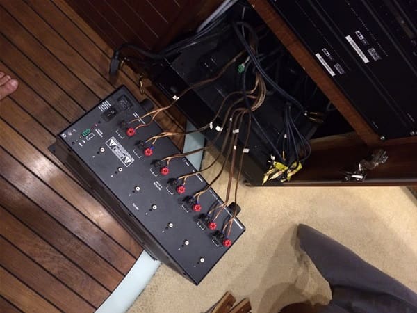

    My biggest project is Audio and Video or AV as they geeks would say.
    I have purchased a couple of Sony AV receivers. One for the front system and one for the back/bedroom system. That set me back by $800 for both. Each receivers has so many capabilities, my current Crestron does not even come close.
    Not only that, I researched the current values of my Crestron components and was shocked to see, how little they are worth today. Well, I should be able to recoup some money by selling them to you or on eBay. … 🙂
    I have had to re-terminate all of the speaker cable connections because they did not have the typical banana type connectors that I need to plug them into the Sony. Identifying the cables was relatively easy. I have a good wirting diagram and with my new labels attached to every one of them, I know exactly where each one of them goes.
    I jury-rigged the set-up and, voila, I was listening to the Lennon Systers on my front Bose surround sound speakers.
    By the way, do you know, how much a Crestron 7X200 amplifier weighs? I sure did not and almost dropped it on the floor because I did not expect it to weigh that much. I looked it up online. A whopping 95 lbs. !
    So far, I have got the radio part figured out. The next step will be to search for and identify the cables which connect the front TV to the electronics cabinet 30 feet away. Needless to say, that I want the TV to work with the surround sound system. I found some cables with labels implying they connect to the TV. That would be good news. Otherwise, I would have to try setting up wireless HDMI.

    Hi Gil, I had Ben ovcr in the bus yesterday. He is not a friend of Crestron. Pretty much for the same reasons that I am not a fan.
    The way I am approaching this now is, to remove all of the components which have to do with audio and video. That is the bulk of the components. I have removed 5 pieces out of 8 components, already. I do have 2 components to go. All of the removed equipment deals with audio and video.
    As indicated in my prior post, this represents a lot of weight. The amps in themselves weigh a combined 200 lbs. and the additional components add more pounds to it.
    I am leaving the Crestron “brains” which contains or manages the software. So far, knock on wood, everything else is still working as expected. That is to say, the lighting, the shades, etc.
    Once I have removed the 2 additional components, labeled Front TV and Bedroom TV, I will be down to bare bones.
    I will also have removed enough hardware to make ample room for the 2 new Sony AV receivers. As mentioned, already, these receivers have many more capabilities, for a heck of a lot less money, than the Crestron hardware which I have or am removing.
    FWIW, I have listed equipment on eBay.
    The saga continues …
    April 15, 2014 at 10:18 pm
    OK, I have disconnected and removed the last Crestron AV component. What you see in the picture is the brains, where all commands are being executed and where the software resides. So far, everything is still working as expected. Now, I have removed 7 components, one stacked on top of the other, and all handling AV audio and video.
    All of this will be replaced by 2 Sony AV receivers, which will do much more than the Crestron and cost thousands less.
    Well, the next exiting part of this job will be to trace wires to determine, which casn be snipped.
    The speaker wires have been identified, already, and they will all be re-used in conjunction with the new Sony AV receivers and the existing Bose surround sound speakers.
    Cheers,
    Ronald

    April 16, 2014 at 10:12 pm
    Someones trash is somebody elses treasure?
    Needless to say, that I want to be rid of the Crestron hardware that I have removed.
    I put the 2 amplifiers on to eBay last night. I could find only 1 reference, where someone else is offering a used amp for $999 – I priced mine at $500 for one and $850 for both, plus packing and shipping costs.
    They sold this afternoon to somebody out West. Now I will get my exercise when I drag these 95 lbs. behemoths out of the bus and over to the UPS Store … 🙂
    The really nice thing about this sale is, aside from removing 190 lbs. of weight from the bus, the $850 which I received do very nicely cover the cost of the 2 Sony AV receivers I had bought on Amazon. I bought an 840 and a 1040 which do have all the bells and whistles.
    BTW, Tom, thanks for your label remark … 🙂 … I do not know exactly how many wires I have labelled but it is a lot! I labelled them with the location from where I unplugged them. Just in case of unforeseen problems. Most of these cables can be removed now. But I have to go easy on that since I may need this or that wire to repurpose it.
    This PM I have started tracing wires and have hardly put a dent into that task. I had to remove a leather covered rear wall inside a closet in the bedroom. Fortunately, it is fastened with Velcro. I got lucky and found at least 4 wires I can trace back to the electronics cabinet. Noty only that, after I removed the wall, I found a big wire chase with more than ample space to run any extra cables. So rather than wasting time and effort on reterminating CAT5 wires with CAT terminals (they have a Crestron plug now), I can just pull some HDMI cables through the chase and be done with it. That is the bedroom. The front living room may be a different story.
