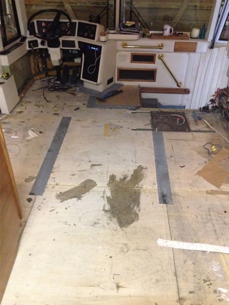

    Pulled my carpet today to do a glue-down of 3/4″ hardwood. Found these metal strips with lots of screws. Any idea what they are? There are two running front-to-back in the salon and then an L-shaped set over top of the section of floor where the sliding hatch is. Can I nemove them so my hardwood lays flat?

    Front ones is where your level floor was extended. There was a much larger top step/landing there once. The other two runninr length ways cover up where the pvc conduits terminate from front to back. I woud say pull them up and take a look and decide if you want to make this area unaccesable from future access. Option would be to remove the strips and screw the sub floor to the frame cross members. and do away with the overlap sheetmetal. FWIW
  • Steven
    March 16, 2014 at 8:28 am
    An alternative would be to rout the wood floor so the steel strips are flush with the plywood,

    OK, I removed the strips and they were just to give the joint in the subfloor some strength. Not sure why they didn’t just run T&G plywood from side-to-side given the bus is nicely 8-feet wide. In any case, I now am thinking I should glue-n-screw some 5mm plywood underlayment side-to-side to unify the floor before running my hardwood front-to-back.
    If someone with prior experience has a better method – please yell!!
    I do have one issue though. If you look at the seam in the second photo, it runs front-to-back over the chassis beam just over the front axle. While this one has a big gap, it is rock-solid. That same seam on the driver’s side which is tight, the edge of the center section of plywood dips and bounces for about a 1-foot section. Hard to believe they would miss the beam on the joint or is there something bolted to the side of the beam under the joint that has come loose?
    My instinct is to pull that center section of plywood and reinforce under the joint, but I must admit to being mystified by how the plywood panels are attached. Each sheet (about 4’x5′) seem to be just attached by large Torx-head screws “in the field” of the panel. I see no fasteners along the seam running front-to-back. It looks like screws are only into the stringers which connect the beams and walls side-to-side. Are the seams glued to avoid screwing into a hardened beam? In any case, need to know what I am facing if I try to remove and replace the panel – or do I just put the underlayment down and not obsess about the one soft spot?

    from the factory that was solid. converter or somebody gaining access to that area has cut it out and replaced with removable panels. If you have cruise Air or something else in spare tire compartment that might be reason. With that panel out you can get to the front end of all the air lines ,power steering hoses ,coolant lines ,electrical cables,everything else from front to back. That area was two layers of plywood from factory. You could take it up and put a support piece up from bottom is soft area or ck the material they used and go back with thick oak boards instead of plywood since your going to floor over it for finished product. Bob

    Robert, thanks for all the help. If someone ran a circular saw down over the beam and miss-measured I guess that would explain why the one spot is soft.
    Tell me more about the composition (layers and thickness) of the floor installed at the factory and what converters like CC typically did?
    The carpeting is original to the converter so this must have been done from the start. Do converters typically have to pull-up sections of floor? This section is right above the front axle so no bay underneath.
