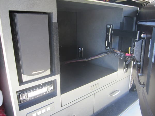

    Working this week installing a flat screen TV in place of factory installed CRT back in 2005. With the help of a former Marathon tech expert advice with suggestions we installed a Samsung 40 inch LED. Normal sound is from the Samsung speakers. The rear box speakers are adjustable separate from the TV with sound adjustable through the radio using AUX mode.
    Normal TV speaker range is perfect but while attending some outdoor events….. Increase as needed such as tailgate events.
    Samsung purchased from Best Buy. Mount purchased from Costco @ $63.00 extends 16 inch from cabinet and turns left or right.
    Marathon 2005 installed TV on slide in-out with turn tray mount New 40 inch Samsung slim line..2 inch thick
    With the latest slim line TV’s the need of having to remove the cabinet shaving off the back was eliminated. Had 3 1/4 inch between front of cabinet and back of closed bay door. TV is held against cabinet with foot long strips of commercial velcro ( seen on right side of speaker) . Just a little wiggle to bring TV out for viewing angle.
