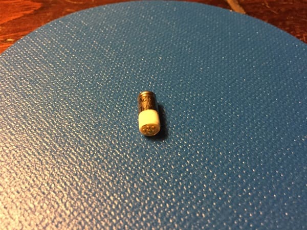

    Anyone have a source for the small LED bulbs Marathon uses for their switch lights? They are Starled, 7-2K, 12 volt bulbs. Went to Starled website, but couldn’t find 12 volt.

    The bulb number is on my post 7-12, but may be an old number. Thanks for the links.

    Jimmy,
    It’s these lights…

    Waltshires, I think those are too big. Our lights are .228 inches wide and .565 inches long. They also have a 7 cluster light arrangement in that small bulb. Maybe that is why they are so expensive.

    These are T1-3/4 MG (Midget Groove) LED’s. My Marathon has EAO 61 series switches. Marathon had the panels made by Swiss company EAO. The bulb in your picture is a 7 emitter bulb just like mine. However, finding this bulb will be troublesome its just old. Newer technology is available.
    Marathon Part # is 103221 or their secondary MFG PN 31-968.15 is $16.39 each
    You can find the EAO replacement on Mouser site by typing in this part number below:
    EAO PN# 10-2J09.1065 this is a green LED 12vdc (single emitter).
    In quantities of 10 = $9.50 each roughly
    To access the bulb I take two 12 spark plug gapping flat blade tools with rounded face edge. Slip them at the top and bottom of lens where the lock grove is located. The groove is just barely in from the face. Tilt the top blade up slightly and pull it toward you and your feel it engage the locking grove. Do the opposite for bottom gage tool but push gage tool down. Pry gently on both gages toward you and bezel will pop out.
