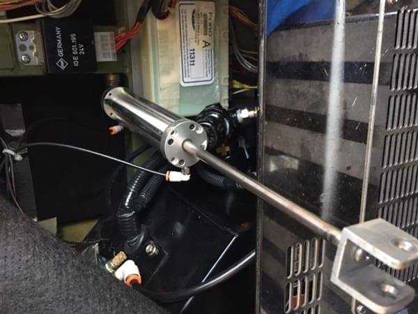

    The attached photo is of the Marathon footrest upfront which the passenger uses. The cylinder is leaking when you retract the cylinder, around where the rod goes in and out. No doubt a gasket of some sort.
    Anyone have to replace either the gasket or entire cylinder for this footrest? If cylinder, is it available on the open market or did you have to go thru Marathon?

    December 4, 2016 at 8:12 am
    That sylinder is easily rebuilt. It only requires a couple of orings. Disassemble it and match the orings.
    Good Luck
    December 4, 2016 at 8:41 am
    The cylinders are made by the same company that supplies the ones for the flipper windows. I rebuilt those with new O-rings and they work perfectly now.

    December 4, 2016 at 12:20 pm
    Well I’m grateful for these two hackers!
    A couple hours of my time & three new O-Rings worth $1.60, and it’s working like a charm! Prevost Aux air leak solved (Yes, Marathon tied into the Prevost Aux for their footrest).
