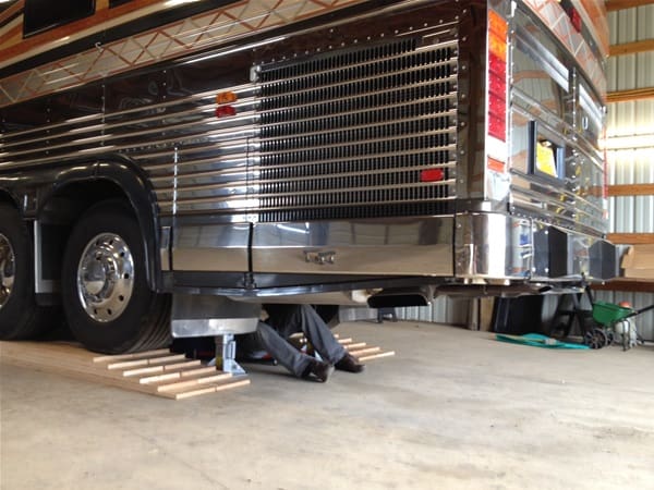

    Finally built some ramps, drove the bus on it, supported it with 22 ton jack stands and started lubing the chassis. With Jon’s instructions on where to look for the grease fittings, things went well. Tomorrow, I’ll double check the differential level and then move to the front.
    Nice to be able to give the bus a good inspection from below. Much to my surprise the air bags looked like new. They must have been replaced some time ago.

    Nice ramps. Is the little trolley in the first pic so you can put them under the wheels and spin the bus round like they do in car body shops? :))

    Could you post pictures and build details on your ramps, please?
    December 20, 2014 at 1:00 pm
    Davy,
    the ramps are constructed out of 6 sheets of 1 inch laminated plywood (factory seconds @ $18 each). Cut into 1 foot wide strips. Glued and screwed together with 2 inch screws alternating locations for each layer. I used six layers going from 8 feet on the bottom to 5 1/2 feet on top in 6 inch increments. I use all four ramps for the rear to support the duals and the tag. They are heavy, thus the dolly.
