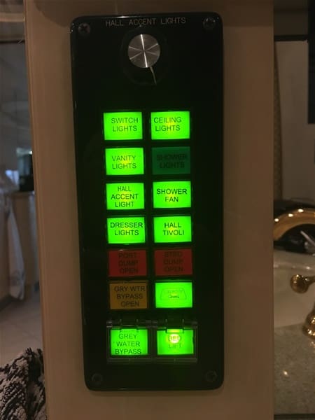

    Anyone know what kind of bulb is in this panel? Maybe a source for them? I have not talked to Liberty, was hoping to find a supply where I could order in bulk at a good price.

    I have one light that is out too. I would think the button/switch would get swapped out from the console rather than the diode/bulb getting replace. I haven’t seen where the individual bulb was sold separately. I even thought about changing it out with one of these console panels from the Knight Rider car. lol.

    Remove the switch cover and look to see if it is a bulb or led. The older ones were bulbs if I remember correctly. If they are bulbs I think the bulb number is 334 if it is 24 volt.

    The bulb is a very small LED in a small round plastic tube. See picture below.
    Any ideas where to get these?

    Andre, that bulb can be removed from the red holder with a pair of twisers…I did some research trying to source these without luck…found them at Marathon for close to $13 each, see invoice with part number.
    Hope this helps…

    Here’s a link for the bulbs: 386 LED
    You can also use a standard 386 bulb although they are quite a bit brighter.

    But I don’t think the 386 bulb will work. The contacts for power or on the side of the plactic tube. The base of the bulb is shaped differnet. I will post a better picture later.
    August 21, 2017 at 7:29 am
    I think the switches are made from a variety of manufacturers and the bulbs are specific to that brand.
    I think the first step in replacing bulbs is to remove one from the switch and match it. An internet search is likely the best way to find the correct bulb once you know what it looks like.
