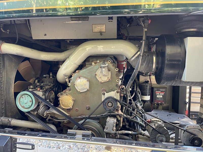

    Looking at a Liberty that seems to have an uncommon alternator configuration. If this once had a DN50, was the old tensioner removed? Does this look like an owner mod or was it possible that someone ordered it from Liberty like this?

    As much as I can remember Liberty has had two standard configurations on their coaches. A 24V Elegant Lady had a single 24V 50DN. The four house batteries were cabled in series and parallel so the house had 12 and 24V power available. The inverters were 24V inverters.
    The Classic was a 12 volt house coach with a 24V 50DN to handle the chassis which needed 24V mostly because of the load or the OTR. The house was 12V and had an alternator of about 145 amps and instead of the 4 house batteries of the Elegant Lady used 3 8D batteries cabled in parallel. I believe the inverters were 12V.
    I cannot say if the coach pictured originally came with a 50DN, but if it was set up as shown it is likely the coach did not have OTR.

    Since this is supposedly a rare non-OTR Liberty it would make sense then there was never a 50DN, never a manual tensioner, and the odd bracket/pulley config pictured is probably as-built by Liberty.
    That said, I’m still surprised Liberty didn’t use the 12v 50DN like Royale did in their configuration (and Bluebird). That would suggest that Liberty viewed the 12v 50DN as unnecessary in a non-OTR Classic Lady. As discussed in another thread, this aligns with the 50DN removal mod that many S60 Bluebird owners are doing these days.

    As I understand it (Jeff or Frank might confirm or straighten out what I “think” is the deal on this coach) in about 1996 or 97 Buddy Gregg was the dealer for Liberty Coach (and probably one or two other converters) and Buddy wanted a Liberty at a lower price point than they had with an OTR/12 volt/Liberty Classic. So “they” came up with two, maybe three, non-OTR Liberty’s. I vaguely recall that a Cruise-Air might be able to run through the inverters so that running down the road a Cruise-Air would essentially run off the alternator on the big Detroit.

    We came across another mid/late 90’s vintage Liberty without OTR last year in LaBelle, FL. Talked to the owner briefly. He didn’t seem overly interested in the technical aspects but did say it would run a CruisAir unit while traveling without the generator. I don’t remember alternator setup but I think it was similar to this one pictured with no 50DN.
