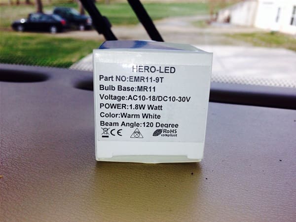

    I also ordered the MR11 bulbs for the vanities.
    What a difference in DC amps. I turned on every light in the bus, 35 and didn’t exceed 10 amps on the inverter panel. The only downside is they are not dimable. The total cost for 40 extended pins and 5 of the MR11 was 248.00.
