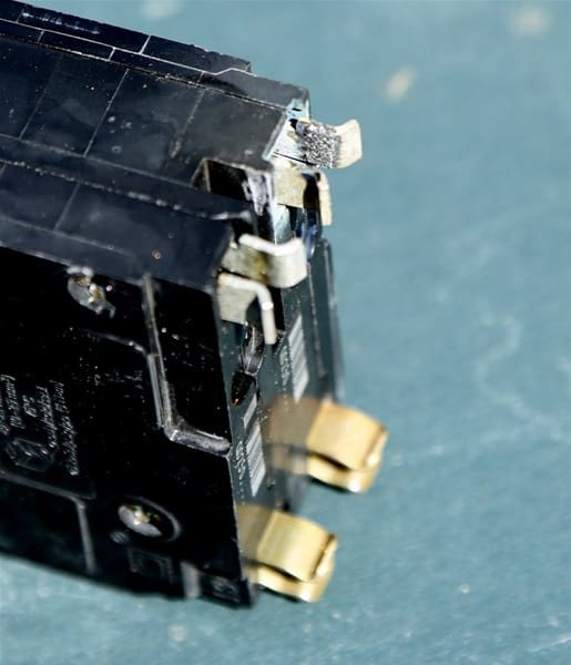

    The other night, on a cool evening with no A/C’s running, suddenly a red light came on the dash along with a buzzer saying “Inverter Loss”. Earlier, I had noticed a slight flickering of the lights and the refrigerator had been flashing a “service” light. Now my worst fears had come to pass: the loss of a 4000 watt inverter. Since the problem had followed us to more than one campground, I knew that it wasn’t the park power.
    It was late and so I pulled out the manuals and started reading. On the inverter panels, one was reporting input voltage (shore) of 104 volts while the other, 118 volts. I checked the plug and it was cool, as was the pole breaker and socket. All looked good. I cycled power and the inverter was still not happy, refusing to go into Shore/charging mode. The other leg and other inverter was OK.
    Next, I started the generator. Everything was back to normal and both inverters were happy. This led to a conclusion that perhaps we had a transfer switch problem. The next day I contacted Marathon and they suggested that I have a look at the main shore power breaker. I removed the breaker box cover and didn’t see anything particularly amiss and measured voltage with my voltmeter. 115 on both legs, so far so good. I then proceeded into the relay box and started taking voltages when suddenly I heard some faint noises and a tiny spark caught my eye. It was the input shore power breaker. The cable leading into it was arcing at or near the connection, and the orange paint was black on the lug.
    My first concern was where to get the replacement parts. The breaker, a Square-D, was a common type, easily obtained. The breaker box backplane, also damaged, was another matter. Looking inside the box, there were no usable part numbers for the box itself so I took the cover and headed over to the local Graybar distributor here in Colorado Springs. Fortunately, the desk clerk recognized the box type and promptly produced a new one from the back room. It was a perfect match. It was a 1-gang breaker box and the cost was $33. The breaker, $60, oh well.
    Below are a couple of pictures of the problem components. Someone asked, “how does that happen”, the answer, simple: a little bit of resistance and a lot of current creates heat that, after a while, will destroy the part. Here’s what they looked like:
    Hope this helps someone 🙂
    -fred
