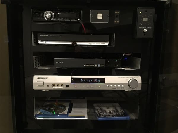

    Above is a picture of the remote app with a OTA TV Guide – The guide stuff is cool
    Above is a picture of the Matrix Switcher
    Yup – it’s a mess… but it’ll get cleaned up soon.
    This is the recieving end of the HDMI signal. Cat 5 into the box – HDMI out!
    This is the “Simple Blaster” the device that Learns and Sends IR signals to control stuff.
    This is one of the convertor boxes – this one is the HDMI Digital Audio Stripper
    I’ll take any ideas on what to do here….
