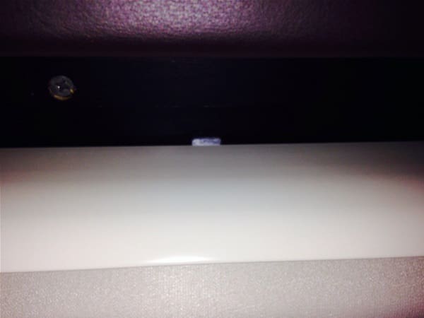

    I need to remove one of my blinds. My Libery blinds were different and the bracket was also different. There are two small plastic clips that I assume need pushed so the blind can sort of rotate and come out of the bracket, but nothing happens and I don’t want to break the plastic bracket. These blinds have no string, the bottom is weighted and when completely down are in the open position.
    There are two of these plastic catches on each blind at the top.

    Tom I had one of mine out to repair motor looks same Marathon number of coach 728 four before yours so prolly same push plastic clip up roll down in front little effort I have one on other side with clip broke put metal screw on end works great thanks Dan
    July 21, 2014 at 10:19 pm
    Tom , my 02 CC had the clip you push and roll the shade out ( there are 2 types of old style clips). It was a total PIA because of lack of space inside the valances. I could push the clip but no room to roll. Hunter Douglas has improved the design so I replaced with the current clips. Now I move a lever to the side and they now come right out. Might be worth the change if space is an issue. I picked mine up at a local Hunter Douglas store but they are on the net also.
