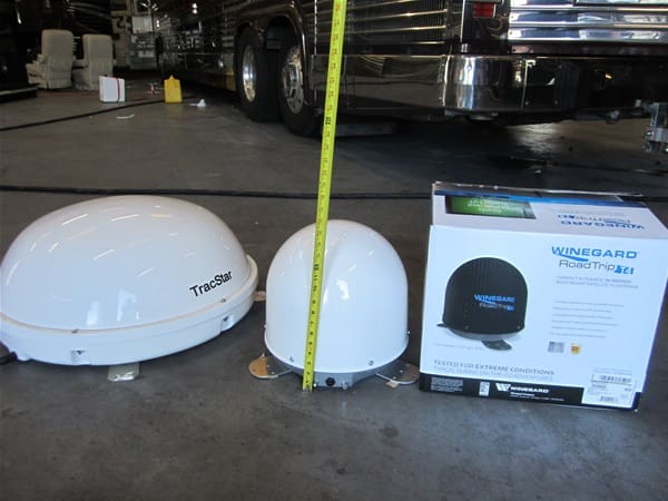

    Many converters are installing the Wineguard T-4 in place of the larger antenna’s. I’am using this T-4 as in fix and in motion now installed in the front cap area. We can see how size has changed in the last couple of years and is the choice of Marathon on all new buses. Switch is installed on dash locking into signal while parked.

    We have an In-motion Winegard Roadtrip Mission dome, model RT4035T, on the forward roof of our bus. It’s small, about 12″ tall. We have Dish service because we like In-motion HD, so Dish or Bell service are the choices. This antenna will do in-motion DirectTV SD. Let me explain.
    For In-motion satellite service, the antenna must fit in a dome housing. DirectTV HD requires a larger parabolic shape antenna because it must receive multiple satellites at the same time. No one makes a dome for DirectTVs parabolic antenna requirement . So, no In-motion DirectTV HD, but SD yes. The above mentioned dome on our bus will do in-motion DirectTV SD. I’m sure there are many others.
    Dish HD service only needs to point at/receive one satellite at a time for HD, so the antenna is small and round and fits in a dome housing, so there are many antenna choices for in-motion Dish HD service.
