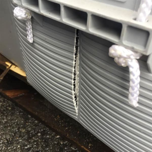

    Here’s what Napa batteries looked like after 2 1/2 years from install:

    Establish replacement dates based on the calendar and try not to end up replacing batteries when they fail. You may save a few bucks getting every last hour of life from batteries, but sometimes battery issues can create other issues or put you in the position of having to spend serious money for replacements when on the road. You can create your own schedule but I swap my batteries out every five years for the Lifelines and AC Delco batteries listed above and while I may be wasting a little money doing that I have peace of mind and no surprises when on the road. If you do choose to stretch battery life, at the very least determine how you are going to work around a failed battery if one does present problems such as the one pictured above.
