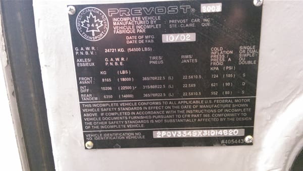

    I’m trying to figure out when Prevost H3’s went to the 18K lb steer axle and 365 tires on both the steer and tag axle. Here’s a Prevost placard for an H3 that has all the above. As shown the VIN indicates a 2003, the build date is 10/02. Some would call this bus number 4620. What confuses me is I’ve seen 2003 VIN H3’s with 315’s on both the steer and tag. I’m not sure what the steer axle rating would be on these buses? I’ve also seen 2003 VINs with 365’s only on the steer axle; I’ve assumed that these buses were upgraded by the owners, maybe incorrectly. Any enlightenment is very much appreciated! Thanks!
    BTW, can anyone tell me what the X in the VIN indicates?

    That coach was built with the 18,000 pound steer axle and it came from the factory with the 365 on the steer and tag. The reason a later coach had 315 is because the shell may have been manufactured prior to the one shown and did not have the 18,000 lb axle or the 365 tires were an option.
    Regardless the data plate is not changed if a coach has aftermarket upgrades.
    I think any time Prevost has built a coach with 365 steers the tag also gets 365. I think the reason is the 365 tires are hard to get so if there is a steer tire failure on the road, you have the option of putting a tag wheel and tire on the steer and using a readily available tire such as a 315 on the larger wheel to get you going.

    The placard above shows axle ratings of 18K/22.5K/14K for steer/drive/tag. If an ’03 H3 chassis has 315’s from the factory, does anyone know what the axle ratings will be?

    I’m really focused in on the ’03 chassis year as indicated by the VIN. I’ll go newer but I really don’t want to go older, mostly because I want the big tires and the axle weight ratings. The coaches that I mentioned earlier with the 315 steers were ’03 chassis as documented in the VIN. It seems that for the H3, VIN year 2003 was a transition year with H3’s produced closer to the beginning of the year adorned with 315’s and those produced towards the latter portion of the year dressed out in 365’s, and I don’t necessarily mean calender year. As we can see on the placard I posted early this particular 2003 VIN H3 was built in October of 2002.
    Here’s an H3 VIN I’ve collected, 2PCV3349331014569, that has 315’s and presumably the lighter GAWR’s. The VIN I posted above, 2PCV3349X31014620, has 365’s and the heavier GAWR’s. So, any bus number greater than 4620 should have the 365’s and 18K steer axle; while, any produced before 4569 should have the 315’s and the 17.2K (guessing) GAWR. Somewhere between there was a transition.
