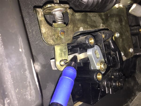

    My dash light stays on indicating a door isn’t locked as discussed in a previous post by Tim. I locked all the doors with the switch and then found 3 doors were not locked. The first door I checked had nothing wrong with the motor or locking mechanism and needed lubricated. Two more to go, but here’s the first door problem.
    This washer holding the spring was causing so much drag when sliding the motor couldn’t overcome. All it needs is lubricant.
    Same with this locking rod that keeps the handle from opening when locked, just lube needed. I’ll be using white lithium grease.
    The motors on the H are not near as robust as the XL & XLII motors, but it takes very little pressure to work the locking mechanism on the H if properly lubed. To access, just remove the 4 screws on the plastic cover then remove 4 10mm bolts and you can access the parts. You can’t just squirt lubricant through the key hole hoping to lube the tumbler, you have to lube the entire assembly.

    I had 2 that were not working causing my light to stay on. As Tom said, a little white lube on the spring/washer and actuator rod…….now my light is off and all working. I lubed them all while I was at it.
    Best way to start out is, activate the bay lock on the dash, then go outside and see which one isn’t locking and start looking there.
    Keep in mind, there is no remote locking feature on the engine bay door, drivers bay, or OTR air bay doors on a H.
    Also, beware of the 3 phillips head screws that go into the plastic housing holding the actuator. On a previous coach, those got loose over time causing the actuator to “lean” over and not activate the switch, but yet the door would still lock and unlock! Drove me crazy finding that one.
