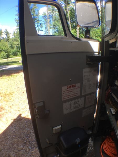

    Big job but worth it replaced all engine seals and gaskets tested for leaks cleaned up and painted. Replaced squirrel cage blower fan, replaced gen bay insulation with a product called Cool It by Thermo Tec, then wrapped exhaust with new heat wrap. Installed Generator and hopefully it should not be a fire hazard anymore.

    nice work! Was the scroll fan for air induction for the genset radiator?
    February 1, 2017 at 10:33 am
    That small fan brings fresh air into the Generator bay then exhaust hot air and fumes out through the floor. The radiator has its on fan separate from the gen bay
