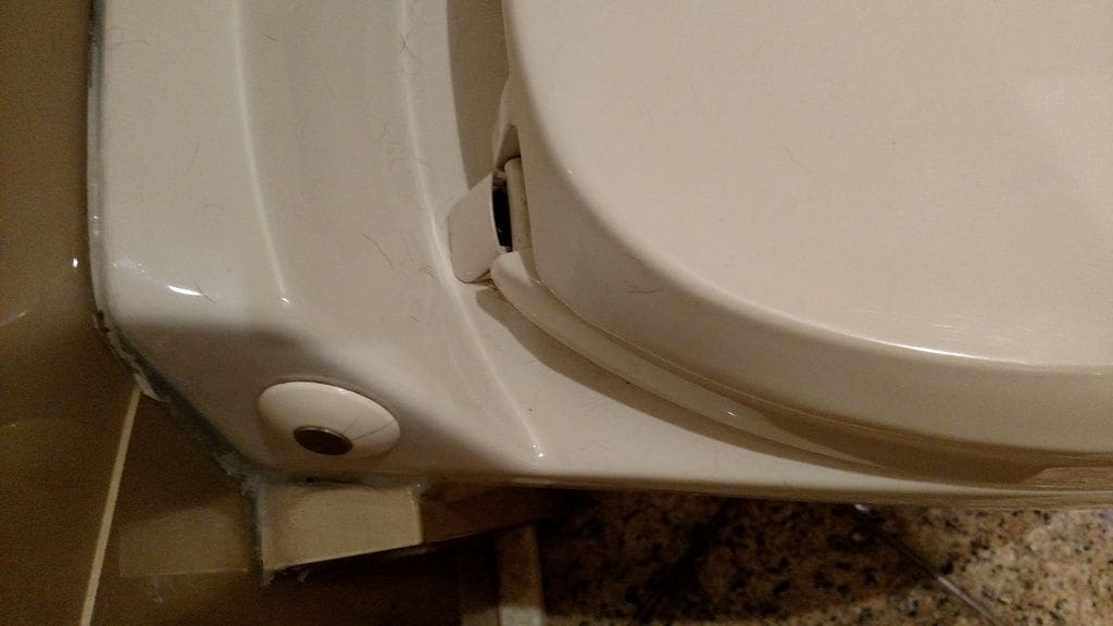

    I’m in Davenport , Iowa and am experiencing intermittent problems with getting the toilet to flush, when I press the button it seems like it is only making a partial contact and starts to flush then stops. I have found by turning the water pump off then on it sometimes resolves itself. So, a couple of questions; does anyone know what brand this toilet is ? Any thoughts on cause or corrections ? Any place around me for repair ?

    It is a headhunter
  • david
    September 3, 2015 at 8:58 am
    Thanks, I’m on their website , it looks like the Hydrovac ?

    The toilet works as long as you have good water system pressure, the water pump kicks on to provide the contiued flow and pressure, and the timer that is part of the push button switch circuitry holds the flush valve open long enough to evacuate the bowl.
    The switch and the timer trips a solenoid in the flush valve that holds the diaphragm in the flush valve open for a short duration. If it doesn’t hold it open long enough (usually a few seconds) some on here have bypassed the timer and allowed just applying pressure on the switch for a while to provide the time necessary to flush.
    But no Headhunter toilet will flush well unless the water flow is fast and of sufficient volume.

    I am not familiar with how Vantare set their Headhunter up with respect to the proximity of the accumulator tank, and the pump. City water generaly will work if it is of sufficient pressure, has the needed flow volume and the accumulator tank is almost directly in line with the flush valve. That is so hit and miss I think most converters that use the Headhunter toilet also use the Headhunter pump and recommend the use of the pump at all times.

    as it turns out you are all mostly right, it seems the pump was the culprit….ironically just replaced original pump as a prophylactic exercise ( no good deed goes unpunished ) with a Mach V…..seems it was shutting down intermittently ….may have been related to the city water valve in wrong position…
