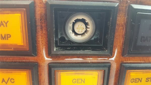

    Auto gen light went out last week….I verified / validated Autogen in the panel – ok – light not coming on. Is there a fuse, relay that is out or just the bulb? I attached the bulb socket photo, if needed where do I buy / part number and how do I replace ? Thanks
    Found out that these are Sunmullon switches, does anyone encounter same issue,?

    Doral,try http://www.devicetec.net. They are in Colorado.Hope this helps.

    September 24, 2015 at 3:26 pm
    If you have any “spares” in other panels you can swap them until you can get one. The whole light pulls out. They only go in one way.

    September 24, 2015 at 4:54 pm
    Mikee, pull out entire switch/unit, not just the bulb? Special tool needed or just flat screwdriver?
    September 25, 2015 at 6:24 am
    Just pull the bulb,not the whole unit. The new bulb will simply pop in………………Steve

    September 25, 2015 at 9:47 am
    The bulb is part of the assembly that moves in when you push it. The part that moves when you push on the buttom is what comes out of the base. The light bulb does not come out by itself. That light is actually made up of a green and red led. to get the yellow color they light up both the green and red. I usually try to pull it out with a small pair of needle nose pliers. Once you get it out you will see how it works. Hope this helps.

    what you are describing sounds like the. CC sun moulin light/ switches . Are those in the Marathon the same?
    September 25, 2015 at 1:29 pm
    Here is another picture of the switch panel, the one missing the cover is the Auto Gen ON, it is not push button just info, ON/OFF.
    The Auto Gen and Battery button are just indicators, not push buttons.Since i do not know how the bulb look like I was reluctant to remove.
