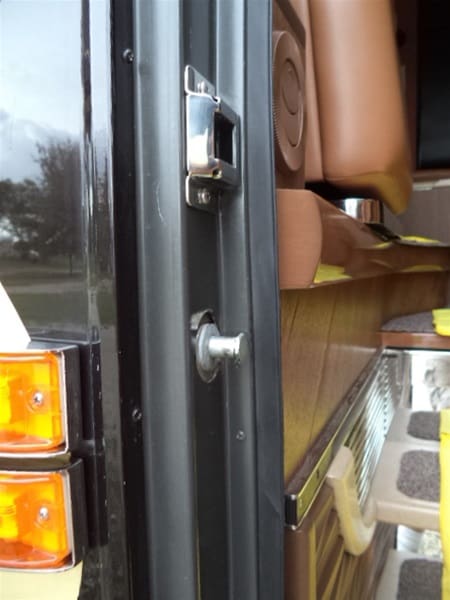

    Here are pics of our door seals that Dorel requested. For the life of me, I can’t find the original thread. So, here are the pics and I hope that they help.
    Dorel, our ‘puffy’ black seal is attached to the door as you can see above.
    There is a black rubber seal that goes around the entrance that is a rather thin piece.

    November 6, 2015 at 8:24 pm
    Mark , thank you very much, looks good. There was no thread, direct email to you for new door seal. looks like my new seal I have.

    January 21, 2017 at 11:04 pm
    If you have a air lock at top of door you can move the striker so it will suck it in more when you drive that sometimes helps or adjust the door it might need a new seal also hard to know

  • Dan
    January 22, 2017 at 10:13 am
    I would inspect the bottom of your door to confirm the rubber seal is in place. That is usually the area getting the most abuse.
    Check seal is all the way around…. is it properly attached, at all corners. The corners are usually the problem areas.
    All is good with above checks. Next, close door completely listening for double click that saddles have rotated around striker pins. In “H” series there are 2 pins, upper and lower.
    Listening for double clicks have happened standing outside push on door near center left side, inwards. There should be no free play in door.
    Let us know what you find with the above checks. Most often the door can be adjusted which is not to difficult.
    Pre-marking of striker is key to successful adjustment. “H”series Prevost usually do not have sticker pins as XL series has. Most entry doors become stretched due to wind catching doors while opening. Door hinges are heavy, heavy duty. Over time some things need to be adjusted to compensate for rough door service.
